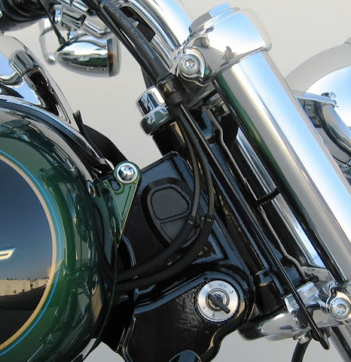

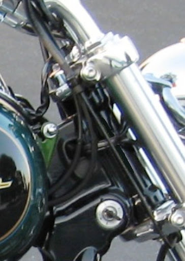

Originally Posted by EricInNCa
Something else to consider is that when you cut the wires, cut them each in slightly different locations (meaning: stagger the locations). That way when you splice them back together you don't end up with a big "clump" of wire connectors in the same location. It helps to make it easier when you pull the wires...
Originally Posted by NOZEM
I made my own extensions, regardless what you do it's a tedious job. Be sure to shrink wrap each individual solder connection then shrink wrap the whole thing. Took a couple of hours to complete the job. not difficult at all. good luck.
Originally Posted by Nazarah
I'll be doing this to my bike as well this winter as a side project, and plan to solder and heat shrink. It's the only way to go to make sure it's done right and will last as long as it needs to.
Originally Posted by archergodwin
Yep. All you do is just give yourself all the time you need (don't rush it), either draw the connectors on a sheet with which wire goes where (or a picture), and it's a piece of cake.
I also acquired some braided nylon wire loom (as well as some stainless braid) to cover the wires coming out of the bars and down to the backbone. I wasn't sure if I wanted the stainless (to match my cables/brake lines) or not. Turns out the black nylon braid looked better.
A lot of good advice above in bold.
Originally Posted by glideridemike
I'm bettin those plug assy's were not redone correctly which allowed them to come apart and short out.
Everytime you make a connection you create a chance for failure. There is less a chance if you use plug assy's and they are put together correctly. Everytime you use solder you put more resistance in the wire run. Maybe its negligible maybe not. But its there. I have also seen solder joints gather moisture over time. No shrink tube is going to keep 100% of the moisture out. Doing it more than once helps, but in all my years of building cars and working on bikes I have found sticking to conventional terminal block assy's to be much more reliable, and breaking down on the road with shorted wires in your bars is a whole lot more of a b!tch than when in a car, so I go with what I have found to work the best for me. My bud also agrees and he's been a HD wrench, service mgr and bike builder for nearly as long. So its not just me.
So I guess we'll just have to agree to disagree. I sure cannot question your work or creations JRK, you make some wicked cool bikes.
I believe a solder joint would be a better connection then any terminal block/ connector, nothing to come loose or corrode. Also gives a full contact connection as opposed to a partial connection that is typical in a connector. Solder two wires together then pull them apart until it breaks, "more often" than not, the wire will break and the solder joint will be intact, try that with a connector and you'll get undesirable results.
If your worried about moisture, just use the appropriate size shrink tubing so that it shrinks down tight enough around the wires insulation, and/or add a bit of silicone sealant to the solder joint before you slide the shrink tubing over it.
As far as your bud being a HD wrench, am I suppose to assume that he a good mechanic and his opinion should over ride my opinions?
To the original poster, another thing to do is make sure you deburr any sharp edges within your handlebars, and while your in there you might want to clean up the rest of the wiring: https://www.hdforums.com/forum/showt...eferrerid=9012
