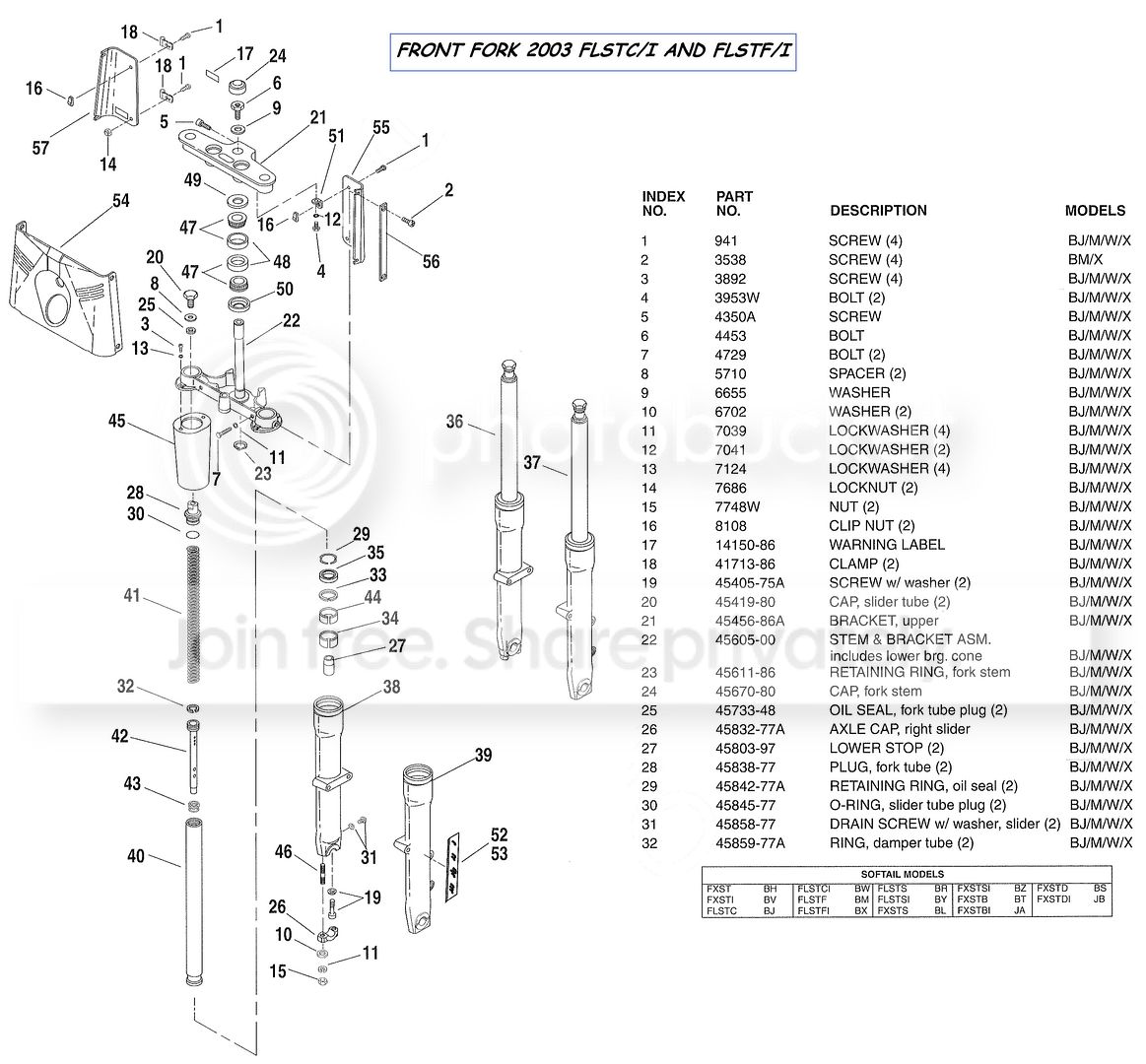

Originally Posted by FXD2003Rider
Here are the first "front end parts diagrams"...
Click the links and you'll find an image in jpeg format which can be enlarged by clicking it and copy/pasted onto your computer
Softail Models Front Brake Control Parts Diagram
2003 FLSTC/I and FLSTF/I Front Fork Parts Diagram
Hey everyone, I’m a little new to this, so just trying to get all sorted out... I’m aware this thread is almost a decade old, but was hoping some of you with experience could help a brother out. I’m riding a 2005 SuperGlide that I want to mod out in this fashion in the worst way. Finding parts is nothing short of a mess on my end. Any help would be greatly appreciated. Thanks!!
