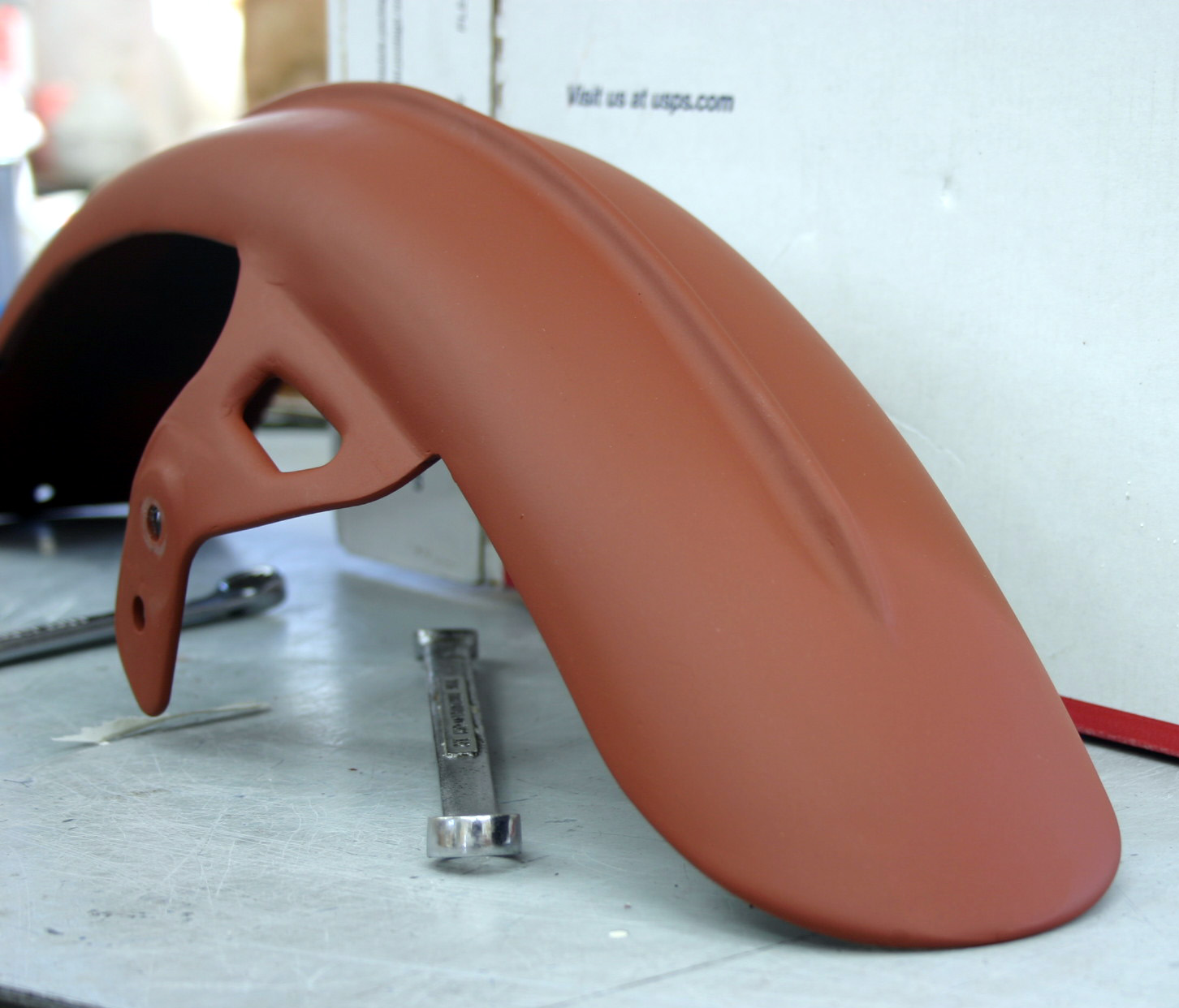

Here ya go JRK.
First, I drilled the four rivets out
and moved the fender back about three and a half inches on the bracket.
Welded the fender to the bracket and welded the original rivet holes closed,
and added a radiused piece at the bracket/fender intersection (red arrow below).
Quarter inch round stock welded on as a center rib.
Also shown is a duckbill at the lower end.
The rib is welded about every inch and a half on each side,
welds on the other side are in between, splitting the difference.
Below is also shown the holding fixture I made for this project.
I road tested this for 5-6 months last year,
suspecting there would be a problem with fracturing.
Yep, fracturing on both sides where the red line is in the image above.
So I welded the cracks, and added an inner rib, shown below.
I don't like the duckbill.
Pain in the ***, but I removed it
Now this end of the rib is terminated with about a half an erection.
The filler I like for this sort of operation is called All Metal, an Aluminized resin.
It gets so hard a cat can't scratch it, just like last night.
Any shaping, tooling, sanding, is best done SOON after the initial set.
I diminished the leading end of the rib to disappear into a thin point.
I still want to reposition the fender a bit closer to the tire.
I'll get to that soon, I guess.........
