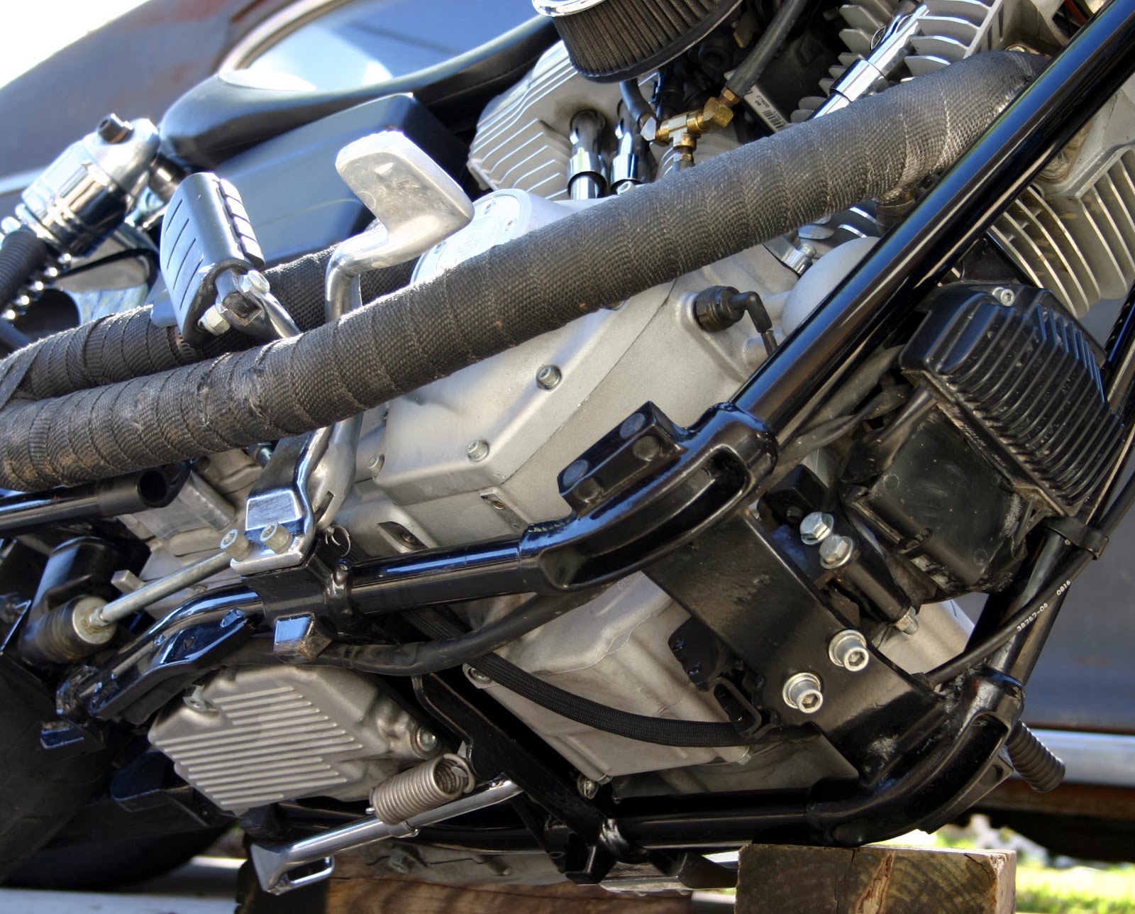

Here's my techniques for leaning the machine way over
to more easily access any operation on the underside.
Or, the once a year greasy side cleanup.
As you see, I'm due for that procedure now.

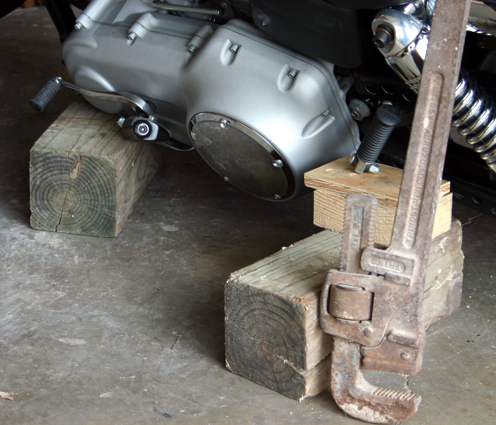

Place the front block diagonally and bridging from Downtube
and over to Primary Housing and Footpeg Bracket.
Rear block under the end of the Rear Footpeg Bracket.
This will lean the machine way over.
Front tire is about two inches off the floor.
Rear tire is on the floor.
Proceed with this one carefully,
and don't blame me if you fork it up.
Check the balance before you get away.
Shown below, you can see under and get in with tools easily.

As to balancing on my lean over technique,
I did say you should check carefully.
Note below, front tire is off the ground,
and the machine is safely planted on the rear tire,
and the two timber blox -
Gotta love the South Texas winters.

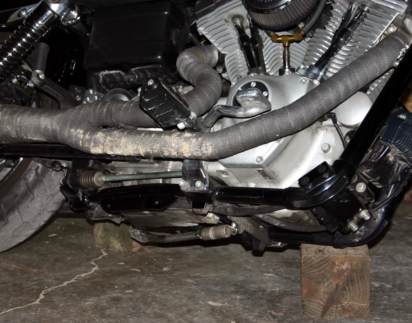

For a positive measure of insurance I may strap to one of the anchors
I implanted in my concrete drive -
Below, the annual under clean makes a big difference -
before -
closer shot added for reynolds............

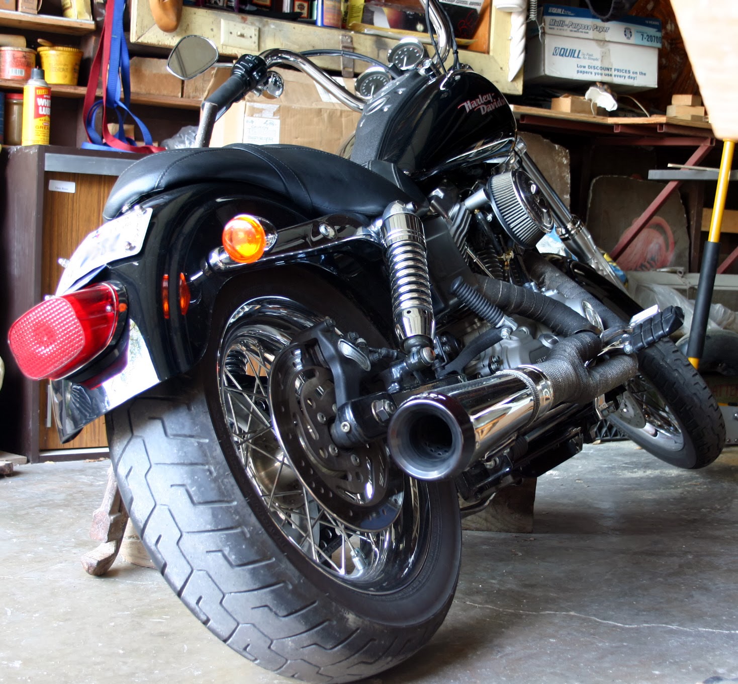

Here's an easy one, and zero dollars.
This is an 06 SuperGlide tank console trim job.
I like this a lot. Think it makes a huge improvement.
First picture - cut to length, Vee notches, then hammer down.
Second pic - weld.
3 and 4 - mock up during prep for paint.
