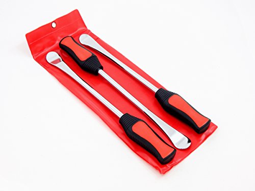

Got some irons
ordered these too
https://www.amazon.com/gp/product/B0...?ie=UTF8&psc=1

Oh. I've got those irons, I think. Harbor Freight? I'm FAR from a tire pro, but the tips may prove a bit blunt and two may prove one too few.
I liked these better, personally. Wear gloves. You'll probably pinch your hand at least once. And use lube. Armorall works good.
It's really not that hard to mount/dismount. Especially if you're not fighting a tube. Lots of good videos on youtube. Just remember you can't stretch the tire bead, so don't try to. You're kinda "hula-hooping" the tire over and around the rim.
https://www.amazon.com/Three-Spoon-M.../dp/B00RYPN0SI
heard. ordered them. i'll drop the others back off at HTF in the morning.

Lol. The HF irons may work fine for you. I was just sharing my limited experience. I'm glad I learned to lace wheels and mount tires, even tho I won't use the skill very often.
if it makes the job easier... fine by me. i don't know what i don't know, so i'm open to guidance.
