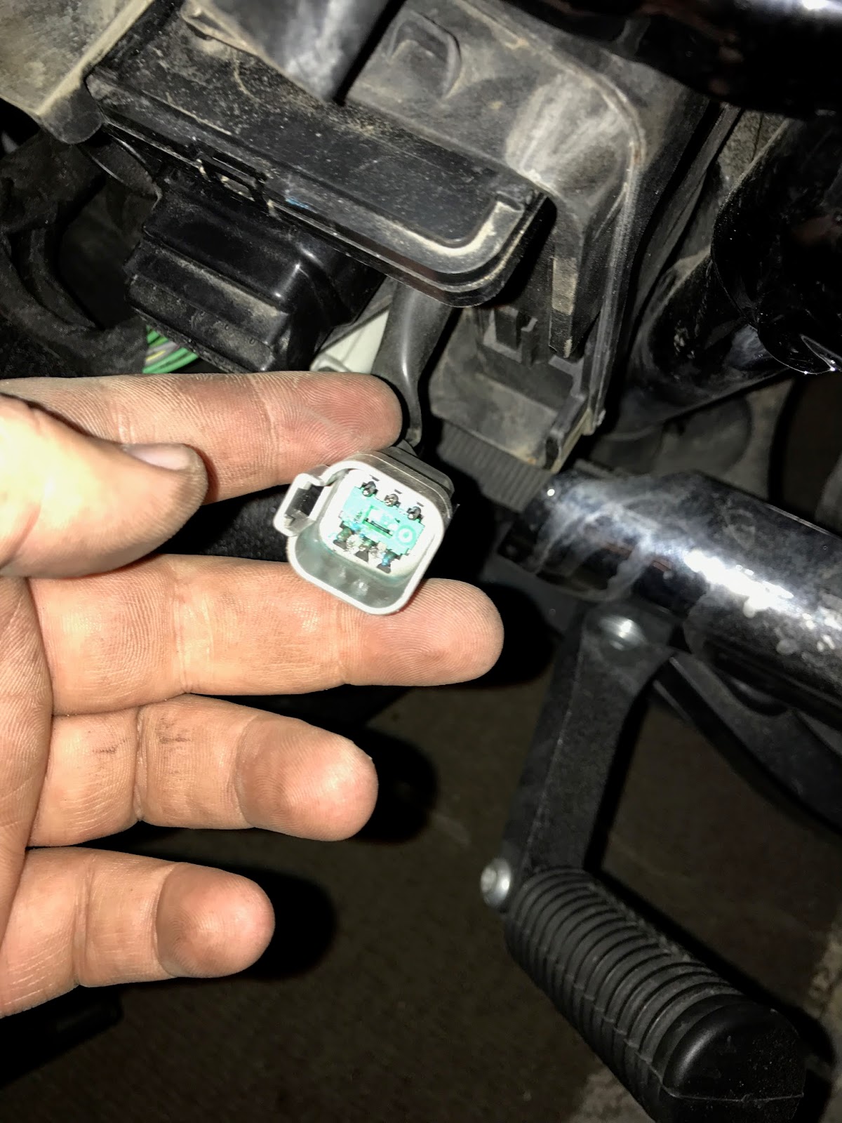

I was out coaching basketball all day and when I got home after dark I noticed a light on in my workshop. I open the door and low and behold the Harley is sitting there with the license plate light on illuminating the entire rear of the bike.
So I start to check the connections under the seat, jiggling everything but the light stays on even thought the ignition is off and the alarm is armed. Best guess at this stage is the wire to the plate light has rubbed through something and is earthing.

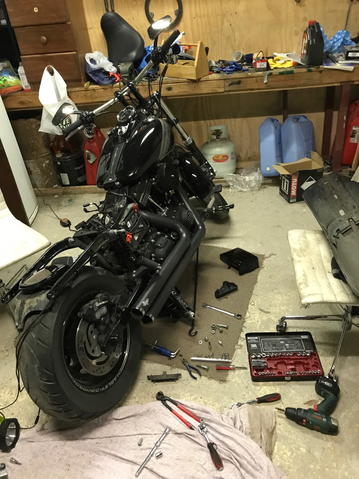

Fast forward an hour and I've now jacked up the rear of the bike up for better access under the guard. I've removed the shocks, the fender strut covers, turn signals, fender and eventually the rear tailight assembly. With it all off the bike I plug the rear harness in again and the problem remains - the bloody light comes on.
At this point I'm puzzled because the rear light assembly is off the bike, if its a cable its not in the rear part of the harness because theres nothing earthing the taillight.
I move some wires around the fuse box to get better access to the wiring harness and out of the corner of my eye I see the license plate light flicker. I Move the FP3 around and the light goes out. Voila its something to do with the data cable. After some more exploring I disconnect the FP# and spot a nice little well of water. in the connector. Some compressed air, some heat and some dielectric grease and we're away.
