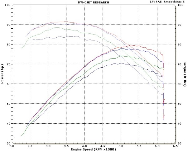

dB tests are to be used as a general guideline which measures sound pressure. Most important to note is that this does not measure frequency which means you cannot draw a conclusion of the tone based on these tests. I can tell you first hand that many times a muffler that sounds louder than another may actually dB test quieter, it all comes down to baffle design and frequency. We spend an absorbent amount of time making the baffles what we feel are just right in the Jackpot Dyno Tuned mufflers using a wide range of testing and customer feedback. Performance wise the Dyno Tuned mufflers make the best Hp/Tq of any slip on muffler and we have even guaranteed this since we started building them and this sets the bar very high for our baffle development. Simply put, since we are starting with a design that makes max hp/tq if we quiet them down it is going to affect power outpot to some extent. I will post dyno charts shortly.

The following dyno chart was done on a 2009 Touring model with Stage 1 air cleaner and PC-V:
RED run: Jackpot Dyno Tuned mufflers
BLUE run: Jackpot Quiet Baffle w/Insert removed
GREEN run: Jackpot Quiet Baffle w/Silent Insert installed
NAVY run: Stock OEM mufflers

Thanks Jamie, that answers alot of questions.
